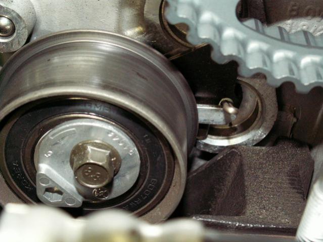

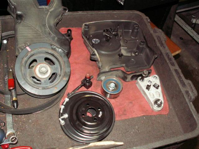

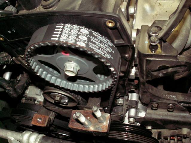

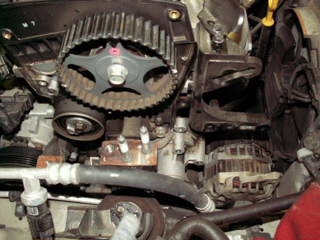

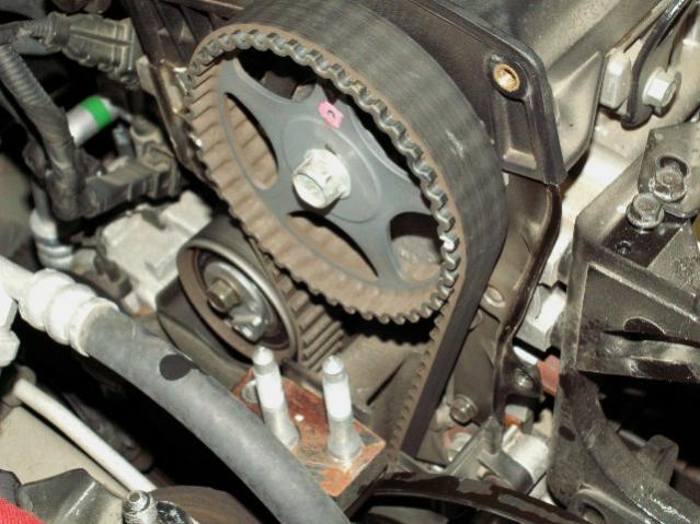

These pics are in Elantra, same as Tucson 2.0 4 cylinder.. The P/S pump was removed to do the water pump, you will leave it in its mounting, the idler pulley with blue seal on the cat was removed for water pump replace, anlong with the lower cover (you can unbolt lower cover and leave it flap in place, flip belt off and pull it out the top.. push the new belt into cover, reach in with fingers and set belt on crank cog, slip it around the idler, holding tight on the "pull" side of the belt, loop it onto the cam gear, and around the tension pulley, set tension, and lock the pulley bolt. Verify timing marks correct, re-assemble.

Basic hand tools, and an impact to knock the crank bolt loose and tighten.. 5mm allen wrench for the tension pulley, but I do mine with long bar for the early, 5mm allen for the late (seen in pic).. The early is a trick adjustment, need to roll it to get pointer past the lock hole, then stick a piece of coat hanger in hole (you can see where I used a cotter pin, as I could not find my real pin),,, get belt on, pull pin, and use allen wrench to snug pulley/belt so pointer is aligned with mark on bracket...
Whatever you do, DO NOT remove the bolt any more than enough to loosen it and get pin set in place, or you'll be mad trying to figure out their stupid idea (old style tension pulley was easy to use)
