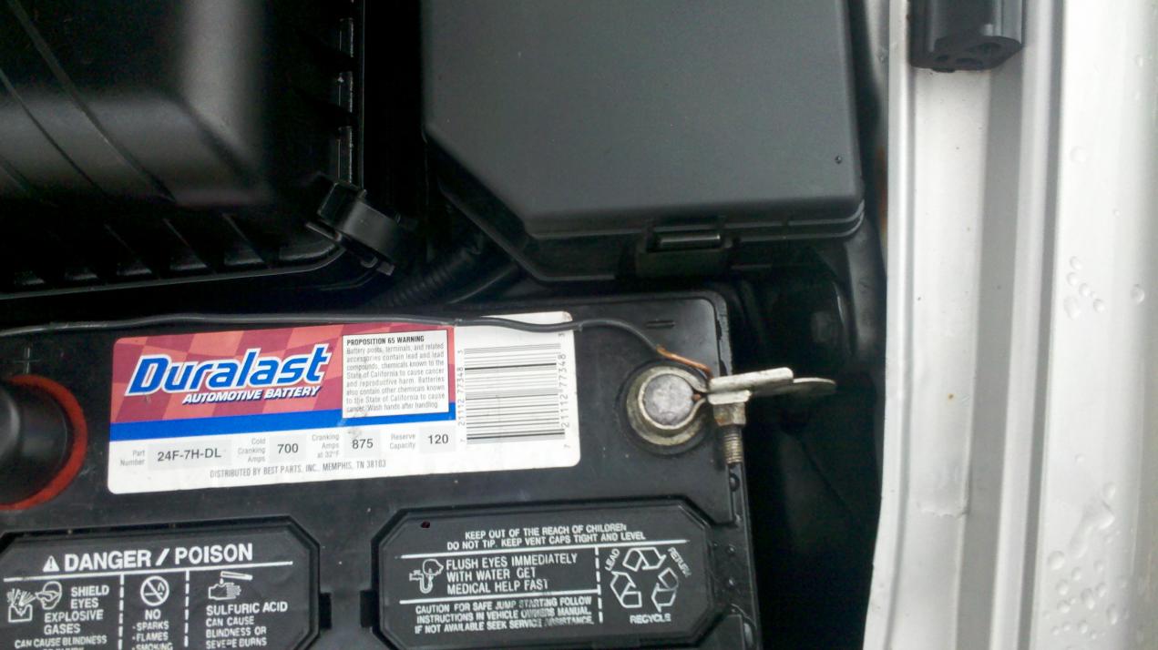

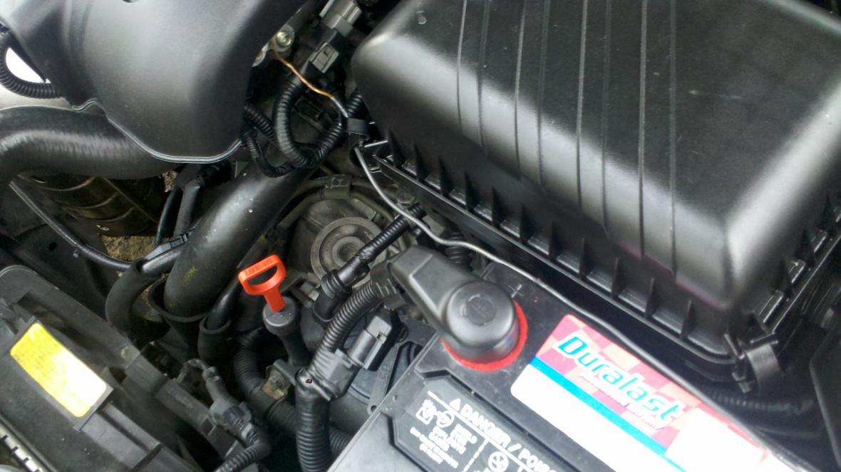

Someone prior to my purchasing it, has ran a ground wire from the negative battery cable, over against the engine block, what for I don't have the slightest clue. I did get one mechanic to take a look at it, he just said from what I'm describing it sounds like an electrical problem.
At this point, the vehicle will usually start up fine, and run great for maybe 15 mins, then it dies suddenly. I can fumble with that wire as pictured, and it'll start up again, and run a few more minutes etc etc and the cycle repeats.
