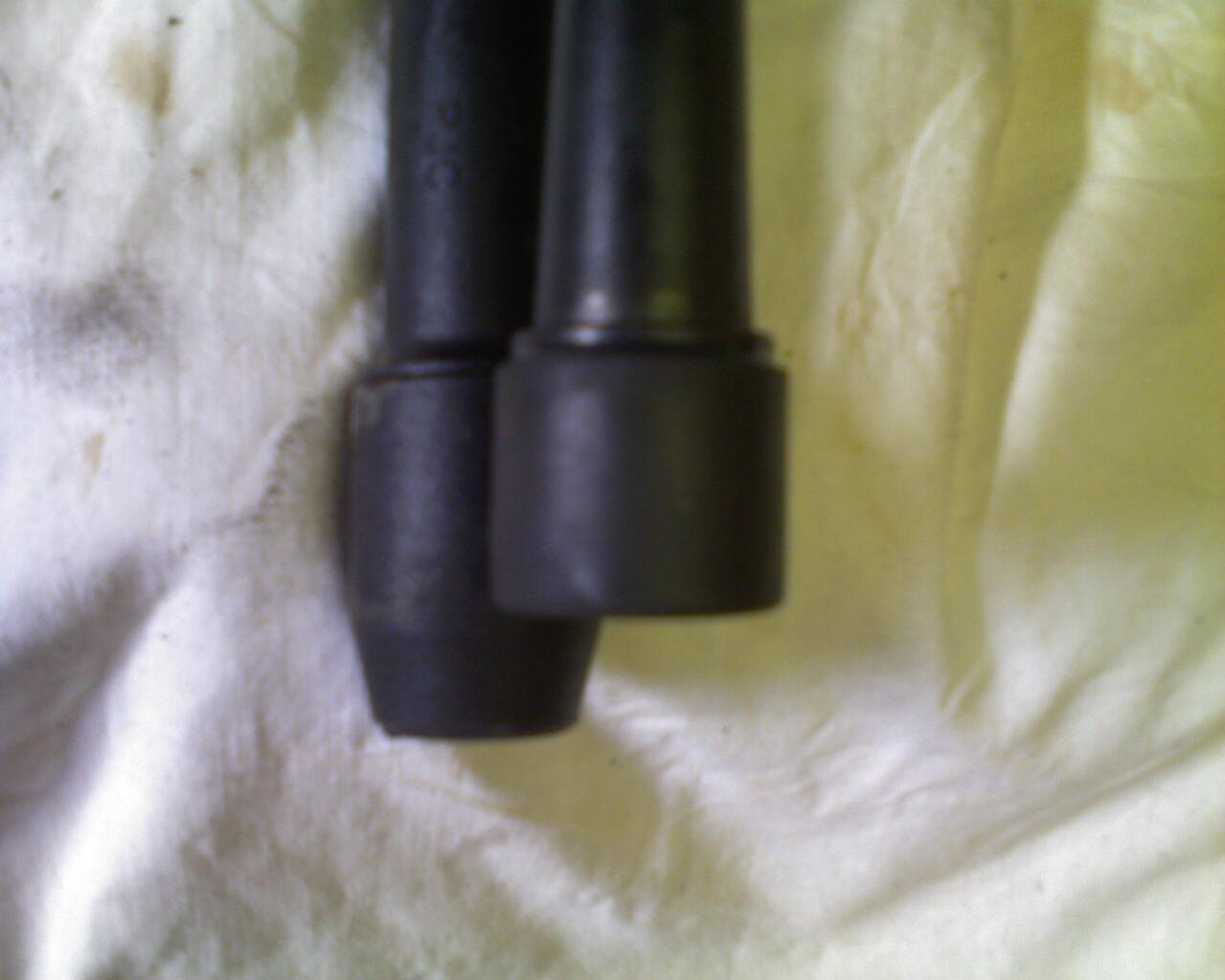

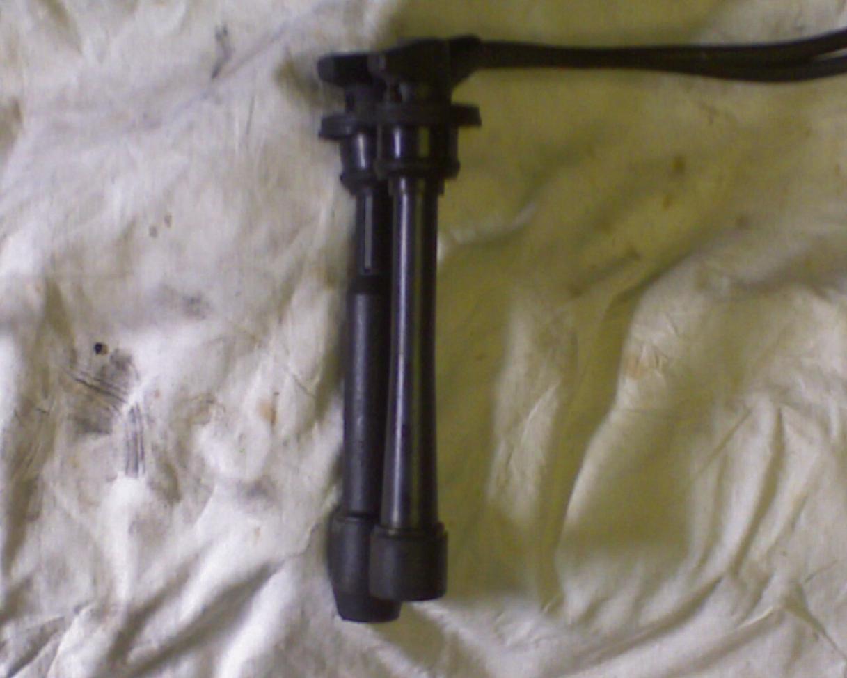

bad spark plug wires...
forgot to mention...Autozone sold me a set of wires that have a longer boot connection that attaches to the plug than the ones I had on the car.
[IMG]file:///C:/DOCUME%7E1/Kevin/LOCALS%7E1/Temp/moz-screenshot.jpg[/IMG][IMG]file:///D:/downloads/Photo_070409_003.jpg[/IMG]
So this makes sense why the a spark plug (or four) may be misfiring. But after I put the old plug wires back on the car I still wasn't able to start it.
I have no idea what to try next!
