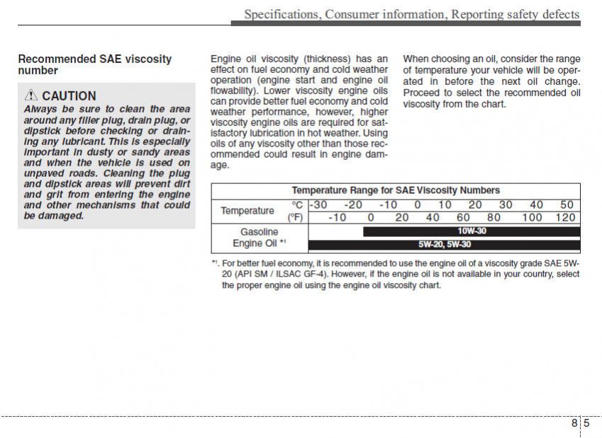

Originally Posted by zielritter
Been using Mobil 1 full synth 0w-20 since first oil change. Manual says 5w-20 can be used for increased economy, and since Mobil 1 says 0w-20 may be used for vehicles requiring 5w-20 I figured what the heck. It's the same price, and if I net a little better economy than 5w-20 all the better.
Except the manual doesn't list 0W-20 as an acceptable grade of oil for the car. You may/may not have troubles using 0W-20 oil, but if you do, using the 0w-20 oil has likely negated the warrenty.
I don't think you read my post very carefully. I said "Manual says 5w-20 can be used for increased economy, and since Mobil 1 says 0w-20 may be used for vehicles requiring 5w-20 I figured what the heck.". I never mentioned anything about not violating warranties, I just said I went with 0w-20 because Mobil1 states on their site it may be used on vehicles approved for 5w-20. Once the engine warms then neither oil will thin more than a 20 weight at operating temperature. So if one wants to be technical, I'm getting better protection at start-up than 5w, and identical protection once warmed up.
Either way, you're right I could get nailed for the warranty, but highly unlikely imo.
