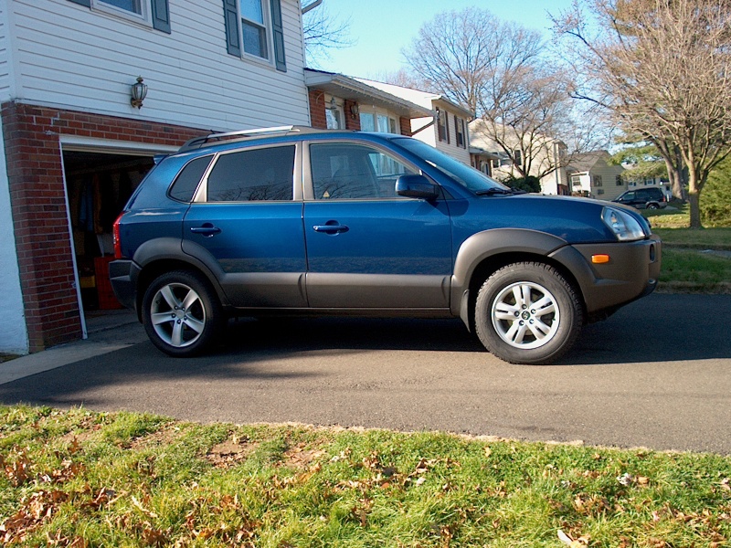

I just installed the 16" wheels and snow tires today. It's a little early in the season but the weather was nice day (cool but sunny). Most places say snow tires should be used once the high temp for the day stays below 50-deg F. It allowed me to wash the 18" wheels and summer tires before putting them away for the season.
Here are some pics showing the difference between the 18" Veracruz wheels and the stock 16" wheels. Drastic difference, don't you think?
I can't wait to but the 18" wheels back on but at least they'll be protected from the snow and road salt. I just have to deal with the TPMS light on.
