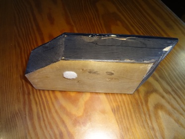

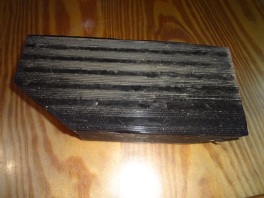

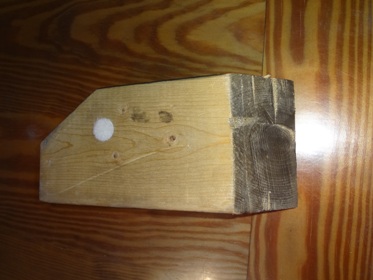

Here is his response.
The overall length is about 7 1/4", but you
can make it longer if you have big feet! I tapered the bottom edge, as you
can see, so it fits flat on the floor, and cut a bit out on the top left to
allow the pedal to fit close to firewall. Bought a rubber stair tread from
Lowes and cut piece to fit over 2x4 for foot placement. A little bit of
Velcro on the back sticks it lightly to the OEM floor pad, so it doesn't
slide around.
Attached Thumbnails Miss Dead Pedal-dsc00861a.jpg   Miss Dead Pedal-dsc00862a.jpg   Miss Dead Pedal-dsc00863a.jpg
