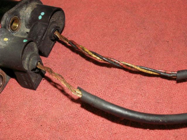

2.7L............. I'd be more interested in the crank position sensor having the pigtail baked and cracked, thus leaving the internal 3 wires bare to short and kill the engine.
Replace them all the time on Sonata, Tib, and Santa Fe, Tucson.. replaced 1 this morning that was really busted up.
